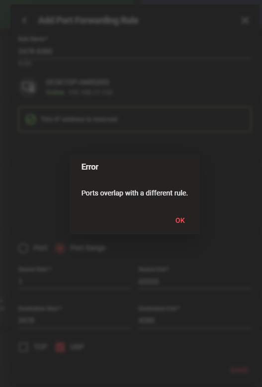

Hey that's great I get it now. Ok so I deleted the other 3 rules then added the port range with source 1-65535 and destination 3074-2074 TCP & UDP. Then, I went to make another rule for the 27000-27050 and 3478-4380 destinations with 1-65535 source, but for both I got this error pictured below: "Ports overlap with a different rule." How do I get past that? -
