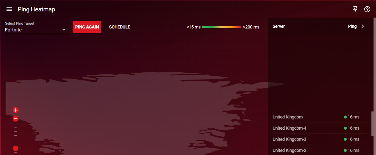

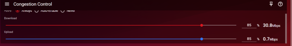

  1. Thanks for your reply. I have now updated firmware etc. I have also changed to device mode instead - Before this method of using DMZ, I just connected to the playstation via ethernet to the XR500 and with the XR500 ethernet from wan into vodafone router ethernet port and the internet still worked etc.. with DMZ disabled What I am finding since using DMZ is that my ping is going crazy... I'll be sitting at 25 ping then all of a sudden 55, then sometimes it jumps to 100 - Back down to 30 and then 25 and it repeats. This is even when It's only me using the internet and other devices are off - Is there any reason why this could be happening? Do I have to use DMZ? or could I just use original method? I just want the XR500 to be my main router to give my playstations more of the internet usage -- EDIT, I've now turned off DMZ and all setup is the same just DMZ is off and now my ping is between 15-35 never higher.... So my question does DMZ have to be enabled? What will I lose if It's not. My main goal is to use the bandwith controller - (Again all devices are connected too XR500 anyway and assigned XR'S IP addresses not vodafones LAN IP's )
