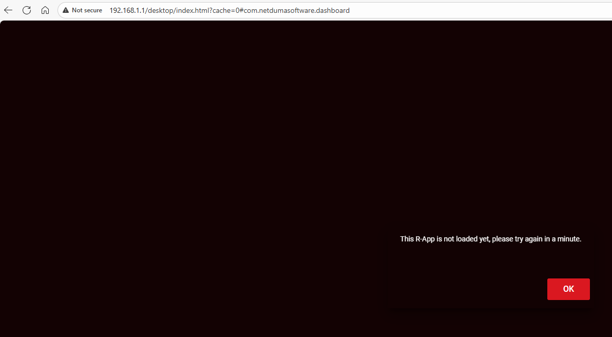

  7. Hi, My XR700 gives me a plain screen with the pop up box with "This R-App is not loaded yet, please try again in a minute" I'm unable to get any further. If I click ok I just get a loading circle and nothing happens. Have tried factory reset, different computers, smart phones tablets etc and same issue. Any ideas what I can try to resolve this? Thanks
