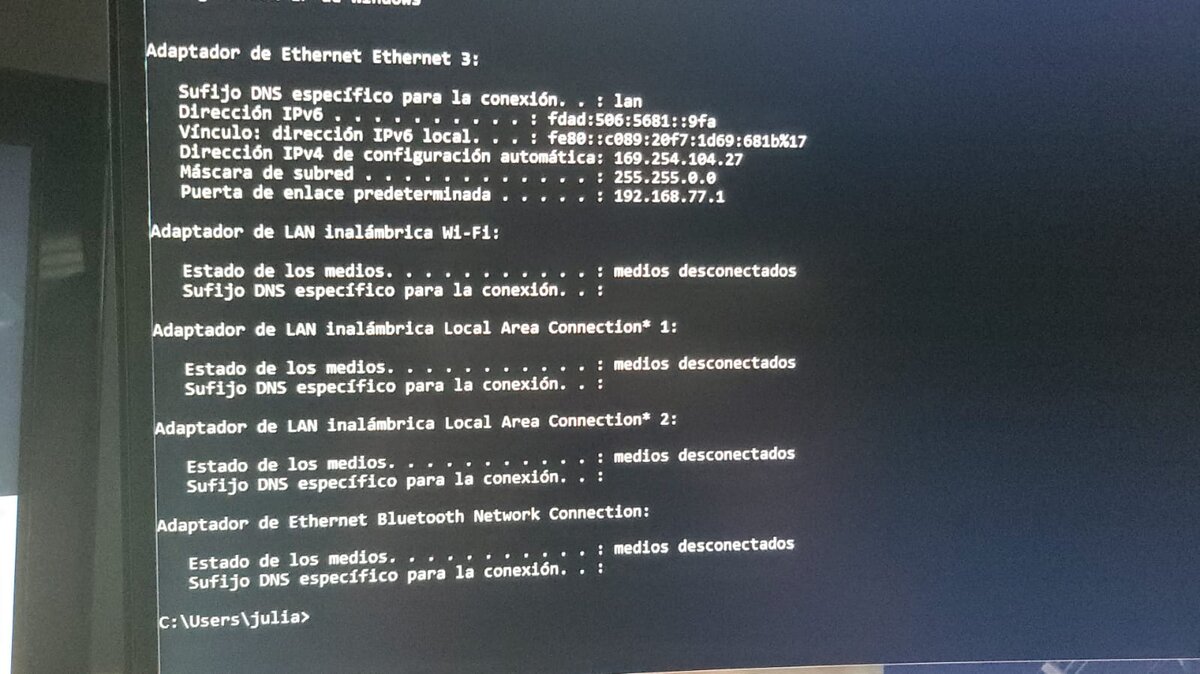

JulesJulesJules Posted June 2, 2021 Author Share Posted June 2, 2021 13 hours ago, Netduma Liam said: Welcome to the forum! Sorry to hear this, is the R2 still giving you an IP address in the 192.168.77.x range? You can check this by opening a command prompt (if using Windows) and enter the command ipconfig. ok, i did that, it entered in to the boot loop, whenever it connects it lasts for a minute and then it dc's, any way i could get an ip for a while, it gave me the 169.254.104.27 i have the text and screenshot saved if you wanna take a look Link to comment Share on other sites More sharing options...
Administrators Netduma Fraser Posted June 3, 2021 Administrators Share Posted June 3, 2021 That's fine thanks, when you plugged it back in did you do the reset immediately or wait for it to boot up first? Unplug the router from power for 10 minutes, plug it in, wait 2 minutes before attempting to connect or access the interface, then try, does it still occur? Link to comment Share on other sites More sharing options...

JulesJulesJules Posted June 3, 2021 Author Share Posted June 3, 2021 8 minutes ago, Netduma Fraser said: Could you take another video please as it looks like there is another LED lit but only saw it for a second sure, thank you for your fast replay i also uploaded the pic of the ip i got when i got one for a second WhatsApp_Video_2021-06-03_at_6_10.20_PM.mov WhatsApp_Video_2021-06-03_at_6_09.46_PM.mov WhatsApp_Video_2021-06-03_at_6_08.47_PM.mov Link to comment Share on other sites More sharing options...

Administrators Netduma Fraser Posted June 4, 2021 Administrators Share Posted June 4, 2021 That's great thank you. Please email [email protected] with a link to this topic and your order number and we can arrange a replacement for you. Link to comment Share on other sites More sharing options...
