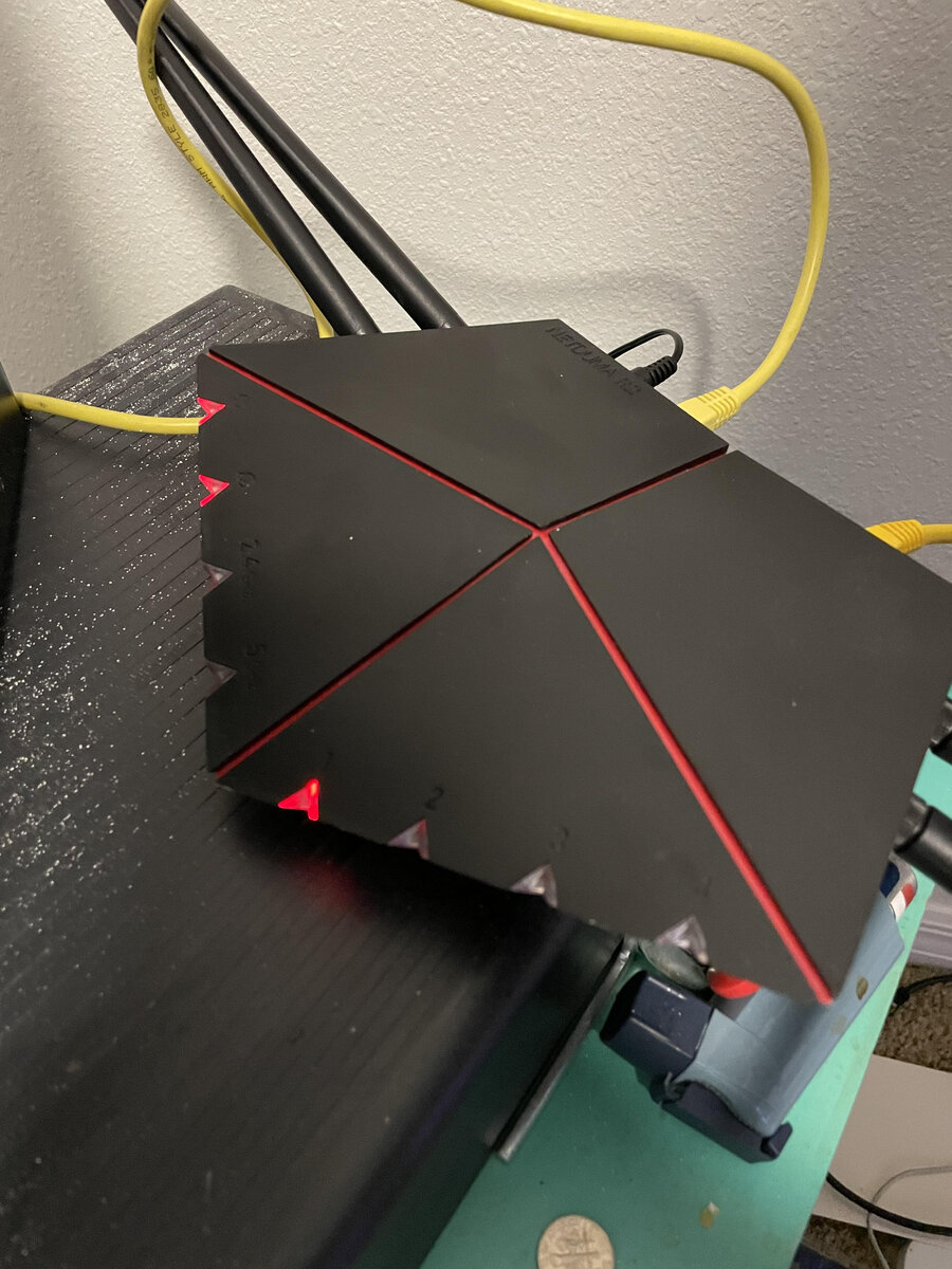

XtremeJrod Posted May 14, 2021 Share Posted May 14, 2021 I've turned R2 on, and tried to connect to the settings using http://dumaos/ as well as tried using the ip address 192.168. 77.1 and neither work or even prompt me to login. I also just see two flashing lights (see picture), though I can access the internet itself through the router. I'm hard wired into the netduma as well. The light on the far left is always solid, but the other 2 lights just constantly flash. I've tried resetting at least 3 times by following netduma's instructions. Help, please. Link to comment Share on other sites More sharing options...

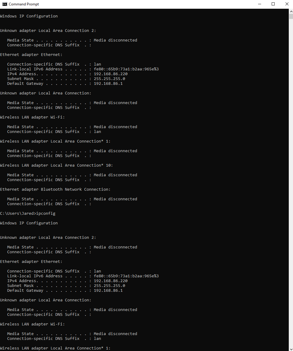

Administrators Netduma Fraser Posted May 14, 2021 Administrators Share Posted May 14, 2021 Hey, welcome to the forum! Sorry to hear you're having this issue. On your PC open command prompt and type ipconfig and press enter, then post a screenshot of the results here please. Link to comment Share on other sites More sharing options...
XtremeJrod Posted May 14, 2021 Author Share Posted May 14, 2021 Here it is. Link to comment Share on other sites More sharing options...

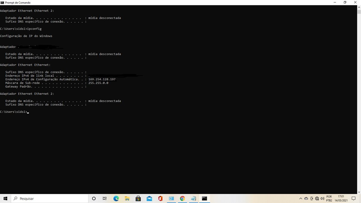

TigerS Posted May 14, 2021 Share Posted May 14, 2021 Good afternoon fraser, my router has the same problem, the light that corresponds to the internet, is blinking and sometimes completely turns off, when I try to do the cmd ipconfig procedure, it does not work because it appears as without a network, but when removing the cable of the router and connect directly to the operator's modem the internet picks up normally. I believe that netduma r2 has some problem with firware. Link to comment Share on other sites More sharing options...
TigerS Posted May 14, 2021 Share Posted May 14, 2021 13 minutes ago, XtremeJrod said: Here it is. mine also when the internet light on the router doesn’t turn off completely appears this number of ip totally different to what we are used to standard of netduma r2. Link to comment Share on other sites More sharing options...

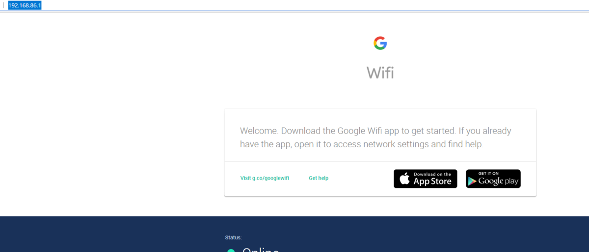

Administrators Netduma Fraser Posted May 14, 2021 Administrators Share Posted May 14, 2021 31 minutes ago, XtremeJrod said: Here it is. If you put 192.168.86.1 into the web browser, what does that take you to? 18 minutes ago, TigerS said: Good afternoon fraser, my router has the same problem, the light that corresponds to the internet, is blinking and sometimes completely turns off, when I try to do the cmd ipconfig procedure, it does not work because it appears as without a network, but when removing the cable of the router and connect directly to the operator's modem the internet picks up normally. I believe that netduma r2 has some problem with firware. Can you provide a screenshot of what ipconfig shows please? Link to comment Share on other sites More sharing options...
TigerS Posted May 14, 2021 Share Posted May 14, 2021 3 minutes ago, Netduma Fraser said: Se você colocar 192.168.86.1 no navegador da web, o que isso leva você? Você pode fornecer uma captura de tela do que o ipconfig mostra, por favor? same thing as the friend above, it's the same fraser problem. Link to comment Share on other sites More sharing options...
TigerS Posted May 14, 2021 Share Posted May 14, 2021 5 minutes ago, Netduma Fraser said: Se você colocar 192.168.86.1 no navegador da web, o que isso leva você? Você pode fornecer uma captura de tela do que o ipconfig mostra, por favor? same thing as the friend above, it's the same fraser problem. Link to comment Share on other sites More sharing options...
Administrators Netduma Fraser Posted May 14, 2021 Administrators Share Posted May 14, 2021 39 minutes ago, TigerS said: same thing as the friend above, it's the same fraser problem. So you have the exact same IP showing, 192.168.86.1? What happens when you go to that IP? Link to comment Share on other sites More sharing options...
TigerS Posted May 14, 2021 Share Posted May 14, 2021 15 minutes ago, Netduma Fraser said: So you have the exact same IP showing, 192.168.86.1? What happens when you go to that IP? just do not enter, type in the browser bar, browser and nothing, because even the internet icon on the pc some, informing without internet or disconnected cable, exactly when the internet light on the netduma r2 some. Link to comment Share on other sites More sharing options...
Administrators Netduma Fraser Posted May 14, 2021 Administrators Share Posted May 14, 2021 46 minutes ago, TigerS said: just do not enter, type in the browser bar, browser and nothing, because even the internet icon on the pc some, informing without internet or disconnected cable, exactly when the internet light on the netduma r2 some. Could you repeat yourself in Spanish please as I think something is getting lost in translation. While connected to the R2 via ethernet, do the ipconfig and post a screenshot of the results - even if it shows the same as above Link to comment Share on other sites More sharing options...
TigerS Posted May 14, 2021 Share Posted May 14, 2021 1 hour ago, Netduma Fraser said: Could you repeat yourself in Spanish please as I think something is getting lost in translation. While connected to the R2 via ethernet, do the ipconfig and post a screenshot of the results - even if it shows the same as above so fraser, the light that corresponds to the internet on the r2 modem, just keeps flashing, and when it tries to fix it, it goes out, when I type ip config or appears 192.168.0.1 or when it goes out, disconnected media appears (and the symbol in windows, it is not connected. Link to comment Share on other sites More sharing options...
XtremeJrod Posted May 14, 2021 Author Share Posted May 14, 2021 So it looks like that is the page for my google wifi router.. I have the netduma connected to the google wifi router via ethernet cable. The idea is that I would use the netduma for just my gaming computer due to the poor wifi performance and range of the R2. So in order from the internet company (spectrum), internet starts with a cable modem, then goes through google wifi router, then connects to netduma R2 then connects to my pc. All connections are hard wired connections. The thing is that this configuration had worked before, but the netduma got into a weird state where internet wasn't working, so I had to reset it and ever since then I've had this issue. Link to comment Share on other sites More sharing options...

Administrators Netduma Fraser Posted May 14, 2021 Administrators Share Posted May 14, 2021 40 minutes ago, XtremeJrod said: So it looks like that is the page for my google wifi router.. I have the netduma connected to the google wifi router via ethernet cable. The idea is that I would use the netduma for just my gaming computer due to the poor wifi performance and range of the R2. So in order from the internet company (spectrum), internet starts with a cable modem, then goes through google wifi router, then connects to netduma R2 then connects to my pc. All connections are hard wired connections. The thing is that this configuration had worked before, but the netduma got into a weird state where internet wasn't working, so I had to reset it and ever since then I've had this issue. It's acting like a switch instead of a router which is why it's showing the Google router there. You'll need to do another factory reset as per the instructions below and then try accessing it. 28 minutes ago, TigerS said: see how it is now fraser, and the internet light on the power side, goes out on the r2 modem often, I can't access anything, and if I put that ip in the browser it also doesn't solve it. The IP you're getting there indicates you need to factory reset the router, hold the reset button for 30 seconds, release, wait 2 minutes then try accessing the router interface. Link to comment Share on other sites More sharing options...
