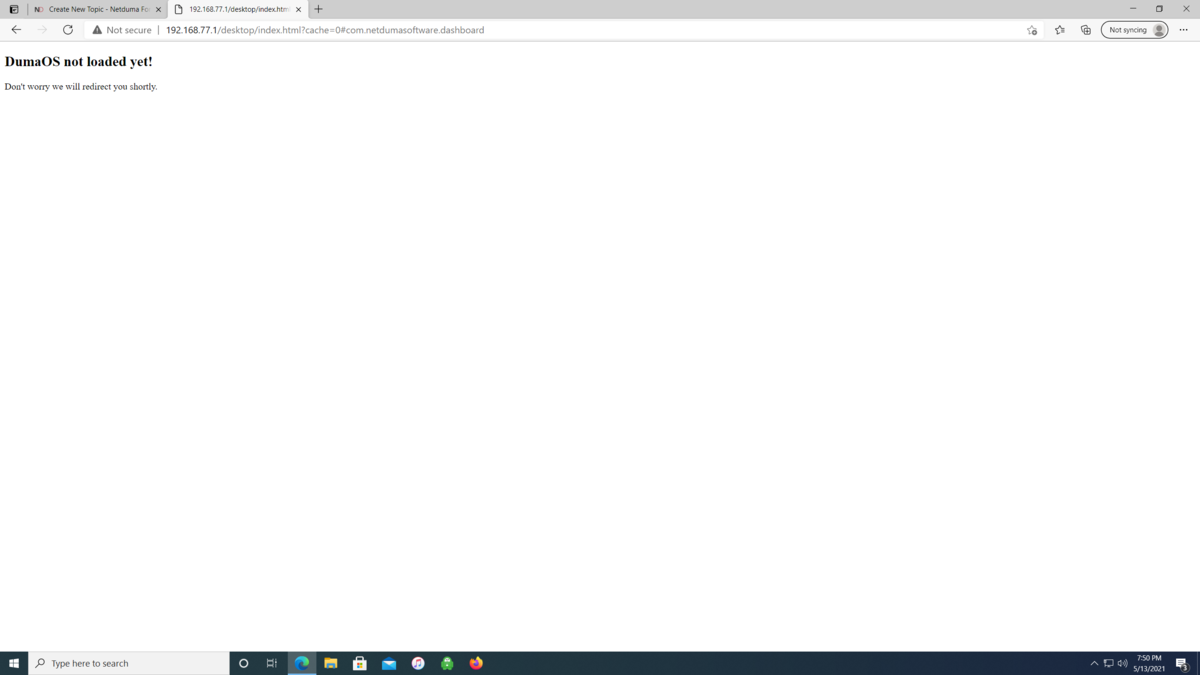

danielson1824 Posted May 14, 2021 Share Posted May 14, 2021 Haven't used my R2 in months. Decided to hook it back up today, and am stuck at the " DumaOs not loaded, Dont't worry we will redirect you" screen. I have reset it countless times. It lets me do the start up wizard, but after that i get the error screen. I searched and only found forum posts about netgears having this issue. Is there a way to fix this on the R2? Thanks Link to comment Share on other sites More sharing options...

danielson1824 Posted May 14, 2021 Author Share Posted May 14, 2021 Thanks for the reply. I’ve tried Chrome, edge, and Mozilla. I put all 3 in private mode, and it was the same result. I also tried the address you recommended in all 3, and it still gave me the same screen. I also tried resetting the R2 again, and do the setup wizard in a private browser. I couldn’t get chrome to load the setup wizard in incognito mode, but was able to get it to load in a private window with edge. Unfortunately it ended in the same result with the DumaOs not loaded yet screen. Not sure what to do from here. :-/ Link to comment Share on other sites More sharing options...
