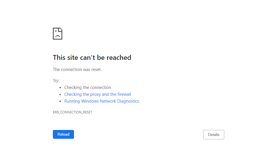

Administrators Netduma Fraser Posted January 3, 2021 Administrators Share Posted January 3, 2021 Okay great thank you, now in the web browser type in and press enter for these: http://192.168.1.1 http://192.168.1.254 http://dumaos what do you see when you go to each of those? - Still keep the router isolated for the moment. Link to comment Share on other sites More sharing options...
Scoflo Posted January 3, 2021 Author Share Posted January 3, 2021 For the first two I get: For Dumaos I get: Link to comment Share on other sites More sharing options...
